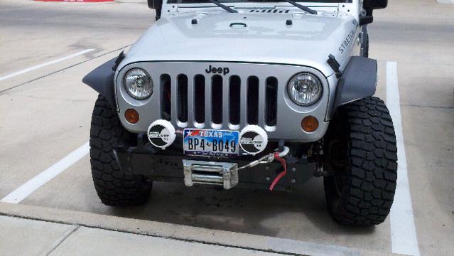

Been running 55w procomps for awhile now. No probs. Wired off factory harness
