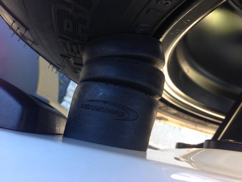

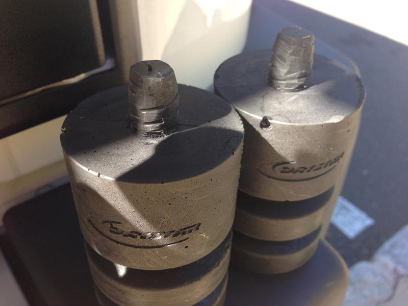

I got the best of the those damn tricky Daystar tailgate bumpstops. I tried installing the set the other day and was unable to get them to install properly. So today I used the trusty dremel, and trimmed down the plastic ends and they popped right in... So with 15 minutes of the dremel it helps save some aggravation.. Just thought I'd share since I see so many posts of people having issues with ends ripping off..
