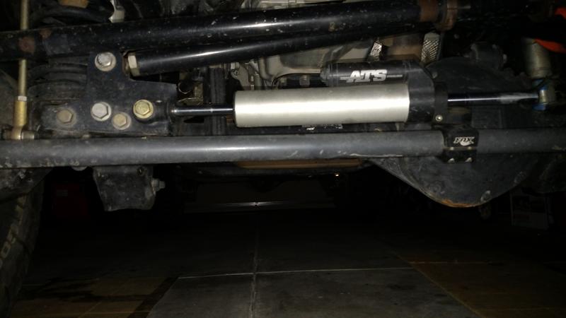

RK 3.5 max + Fox ATS, no issues. I had it on the stock tie rod before this Synergy but did not have any contact issues with that either.

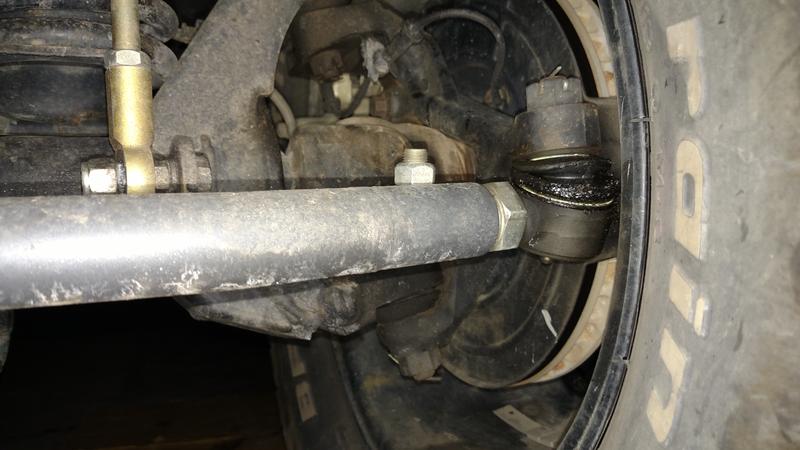

Hey fredrok - can you send me a pic of your tierod ends? It looks as if your tierod is lower than mine which allows more clearance. Interesting .

Originally Posted by fredrok
<img src="https://www.jk-forum.com/forums/attachment.php?attachmentid=584398"/>
Thanks Fred, does the synergy tr have angled ends or is it straight?
