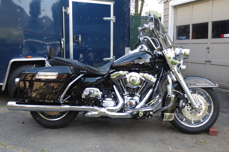

Default i have not had one issue with my harley
Originally Posted by FDHog
My Fox ATS works so well I don't even know its there, but if it wasn't there, i'd know it.
No push, no pull, just nice firm steering.
I always love it when guys who don't run a piece of equipment have a bunch of negative crap to say about it.
I'm the one spending the money, so don't get your panties in a bunch.
Granted, I wasn't happy with it coming apart, but Fox is upholding their part of the bargain.
Works for me.
BTW DJ, I have the same experience with Harley clothing. All their crap is now made in China. I have one old Leather Jacket and vest that were made here, but no more.
never went in for a repair even . Wish my jeep was the same but it had issues in the past , hope there gone for good now. (buy USA) winter time its the jeep btw HD leather is from China made from Dog skin for those who dont know that

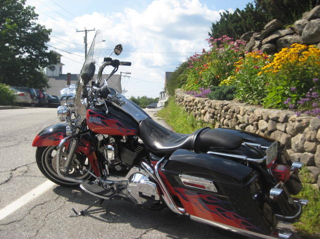

Nice ride Mojo. Here's mine.

Default lol sweet another road king 12" bars ??
love the road king theres to many ferrings out there ill never get rid of mine
