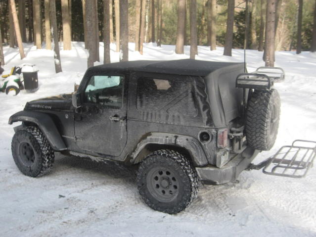

thanks yeh grade 8 ~ 9/16 is staying your set up looks great no salt like mine under there lol
wonder how long that 325 dollar shock will hold up to salt here in nh / not long i bet
