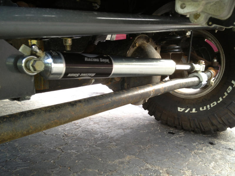

Originally Posted by Biggy
I have no pull what so ever with the standard fox ss.
X2
I was told from the seller the instructions were changed to lower the psi ?
Done know if there is truth to this.
He put 15 psi in for me and I have no pull whatsoever.
What psi is common for folks that run this shock?

Originally Posted by kjeeper10
X2
Ken,
I've seen a similar psi on quite a few threads with schrader valved stabilizers.
Looks great under there! Where did you get it and how do you like it compared to others?

Originally Posted by Jayrubicon
Ken,
Thanks,
I bought it used. For some unknown reason my jeep is handling better without the Ss. Dunno ... I have some funky crap going with my steering.
