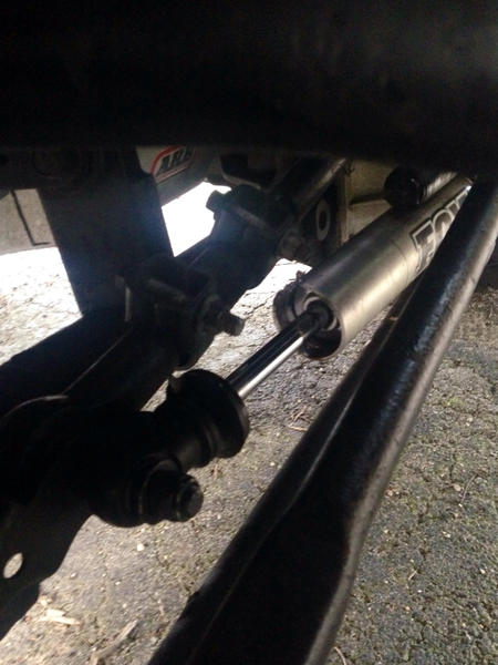

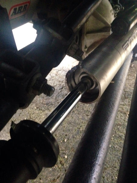

I'm about sick to my stomach! I love my Fox steering stabilizer and feel it was worth every penny. My ball joint on my drag link failed and I started having issues turning to the right. It only happened a few times. I ordered a synergy drag link. When I dropped off my jeep to have it installed we noticed damage to my Fox steering stabilizer from it hitting the bolts on the Teraflex track bar. I guess it is obvious now what was causing the steering to stick. Just glad I didn't hit anybody. Click image for larger version

ID:	567400 I think I'm pretty much screwed. I'm going to call Fox tomorrow and hope they can repair vs having to replace the whole thing. Ugh!

I had problems with my steering stabilizer striking similar bolts and ended up rerouting it to the drag link. Serves the same functionality just as effectively, but gave me the room I needed to clear the bolt heads.

This is why you are supposed to fully cycle the suspension after install. My TF bar never hit , but I think you can loosen and rotate just the clamps without effecting length?
Or grind down or use a shorter bolt.

Your right. You can loosen the clamps and rotate just them.
