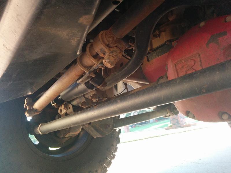

When there is some light outside. :-)
Note that I have the Currie rods, not OEM.

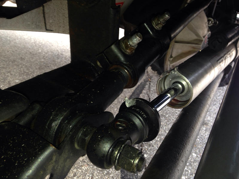

So here's what we think happened. The collar from the adjustable teraflex trackbar ended up spinning until the bolts interfered with the fox stabilizer when turning right. We suspect the fact that the track bar collar even spun in the first place may have to do with the bolt that holds the fox stabilizer in place also holds the end of the track bar in place. But....that is pure speculation. This design actually helps address the fact that Jeep installed an undersized bolt to begin with so. I liked the design from the start. Here's where the track bar bolts were when it caused the damage. I drove for just shy I a year with no issues including a ten day trip to Moab this past April with no issues. Click image for larger version

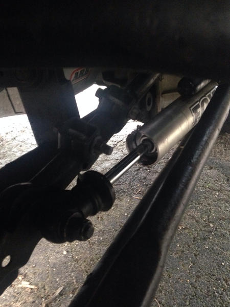

ID:	567526 Here's where they started and I moved them back to. Click image for larger version

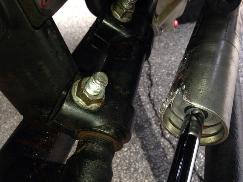

ID:	567527 Another angle. Click image for larger version
ID:	567528 The guys from Fox are taking a look at it to determine if it can be repaired or if I need to replace. I hope it can be repaired because it really does a nice job and has a great feel on and off road. Stay tuned to learn if it is repairable or disposable. I suspect they will be able to repair. These are built well!

The hardware for the clamp is shitty on the TF TB. Mine stripped when torqued to spec (with a calibrated torque wrench). I installed grade 8 hardware and it's all good now. It might have not been tight enough and worked loose with heavy wheeling. Hopefully the SS can be repaired because those things are expensive.

They should be able to replace the can and end cap.

[ QUOTE=Ncb;3956369]The hardware for the clamp is shitty on the TF TB. Mine stripped when torqued to spec (with a calibrated torque wrench). I installed grade 8 hardware and it's all good now. It might have not been tight enough and worked loose with heavy wheeling. Hopefully the SS can be repaired because those things are expensive.[/QUOTE]
Crap ... I never thought of this. I agree 100%
I had to do the same .. Two new grade 8 bolts. Both stripped on me torquing to the required spec.

Note that I have the Currie rods, not OEM. <img src="https://www.jk-forum.com/forums/attachment.php?attachmentid=567448"/>
Pretty cool! First time I've seen that on a jk!
