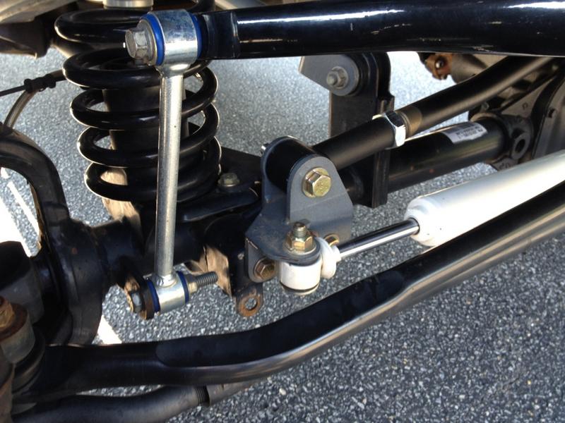

So yesterday I had my shop install my front and rear adjustable track bars and I have a mounting question in regards to the front.
I previously had a BDS relocation bracket on the front and rear and they didn't remove the front relocation bracket to install the adjustable. Instead, they mounted the adjustable to the relocation bracket and said this would allow more clearance for the steering stabilizer since its now mounted on the top rather than bottom.
Make sense?
What is best? To mount the adjustable track bar to the stock mounts or keep the relocation bracket for clearance?

Anybody have pics of their adjustable track bar mounted with a steering stabilizer? I want to compare to what i have....
Thanks!

Riiiight, which is exactly what i said to my shop as they were installing the bar but they said it would be better to keep the bracket so the stabilizer doesnt get wacked out of shape.
Anybody have pics of their adj bar with a stabilizer?
pics attached of what i have on now. Have been driving it all day and haven't had any road manner issues...
Name:	Adj track bar 003.jpg

Adjustable trackbars recenter your axles, trackbar brackets (raised/drop) help to correct the geometry. Now both are not needed in all lifts.

With that said, should i leave the bracket?

If the bracket is there to change the angle of the track bar and reduce bump steer, then it works as well with either track bar.
If the bracket is only there to center the axle when using a stock track bar then it might as well be removed.
Its probably not hurting anything either way.

That would depend on how it handles for you now. Do you have bumpsteer?

Ahha, the shop said it would be best to avoid with bump steer.
No bump steer here, , guess my question is answered...
It stays as is.
Thanks guys, much appreciated feed back.
