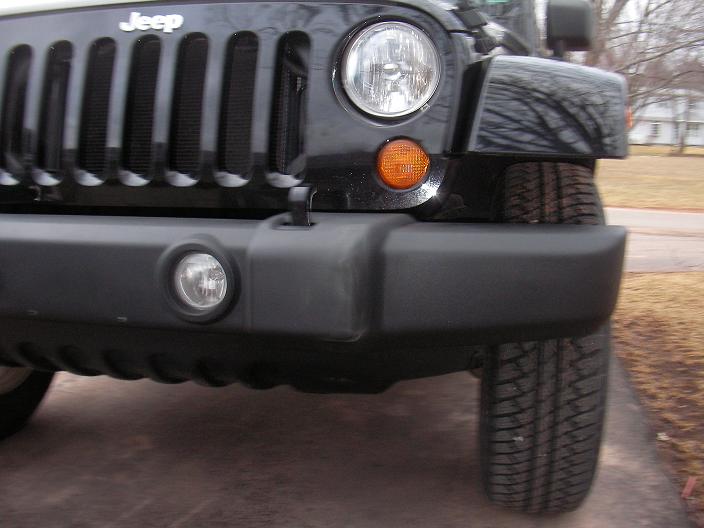

I figured I would post this in this section as well becuase most people have either changed their bumpers or removed it. I hit a small post and it pushed in the section to the right of the front bumper. How can i get inbehind that fron cover to push it back out.

Get up under there and you will see the plastic covering with the dent will un screw pretty easy. I would take it off and punch it from the back, it should reform to original shape. a little heat may help.....never done this but if I had to this is what I would try!

You pretty much have to remove the whole bumper-the plastic won't come off with the tow hooks sticking up-and they are bolted with the bumper bolts. I removed the plastic to mount tow bar brackets and it does'nt look too bad.

I put a 2 hairdryers to the jeep bumper and once it got hot i just pressed the plastic around until it they popped out.... it came out pretty good.. Just need to find something out there that will remove those types of scratches but I don't expect to find to much.. Anyways scratches build character..
Thanks for the replys. here she is now..
