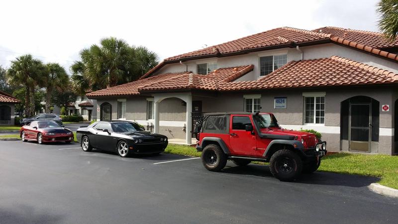

2011 auto jk 3.8 2 door lifted with OME 2" HD coils ( i tow a lot across the USA) with a smittybilt front bumper and winch and rear Rockhard 4x4 full rear bumper (240lbs weight) the jeep sags in the back as you can see in the picture.. I put the lift at 12,000 miles and it now has 66,000 miles and its the first time the driveshaft failed(front) failed..

Attachment 580703Attachment 580704
