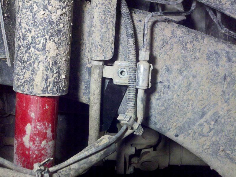

So I'm installing my rough country budget boost and maybe I'm just stupid, but I can't figure out how the front drivers side bracket works. It seems that there isn't enough play in the metal break lines to allow the bracket to work. Any help would be awesome...

What year is your JK?
This worked for my 2012....
https://www.jk-forum.com/forums/show...BB-Lift-Design

Look under your fender liner, the hardline is snapped into a multi clip of sorts, unsnap and carefully bend the line down.

You don't need front extensions with a 2" BB lift. Just rears.
