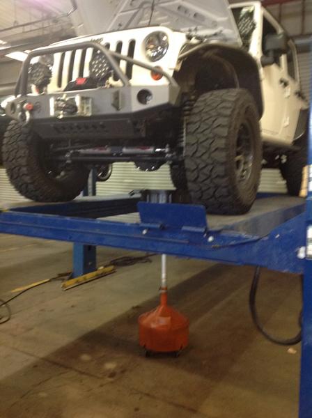

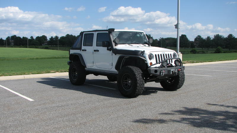

I need help planning my next line of upgrades. As she sits now there's about 20k in parts alone dropped into her. I want to make the best decision for the next couple of grand that she's gonna see. Hopefully with this round she will be complete.
Jeep upgrade list
  1. RiverRaider JK weld-in sport cage kit
  2. Artec industries D30 axle truss & sleeve & gussets $249.99
  3. Synergy chromoly tie ROD $325.00
  4. Reid racing conversion knuckle high steer arms$169.98
  5. D30 conversion knuckle bolt kit $49.99
  6. Reid racing D30 conversion Knuckle $279.00 x 2
  7. Artec rear axle truss $149.99
  8. ORO air operated sway-loc $888.99
I'm already too far invested in my D30 to abandon in. (Chromoly axle shafts, upgraded ball joints, aussie locker, 4.56 gears) The goal is to build a bulletproof 30 hence the abundance of work being done on the front axle. Anything i need to change from the above?
Next is the cage. I plan on doing a good bit of wheeling and i recently had twins. I'd feel a lot more comfortable if I supplemented the stock cage with river raiders cage. I saw their work first hand at the All Breeds jeep show and I was impressed with them.

You are throwing money at a future headache.
Ditch the 30.... and swallow the loss. It is impossible to build a "bulletproof" d30.

All that high steer stuff you listed is for tj's. They don't have high steer arms for the jk reid knuckles. I'd look into the synergy cage if you want a weld on addition. The river raider isn't designed very well. If you do some research on cage design you will see why I say that.
I wouldn't put money into the Dana 30 if 37s or 40s may be in your future.
