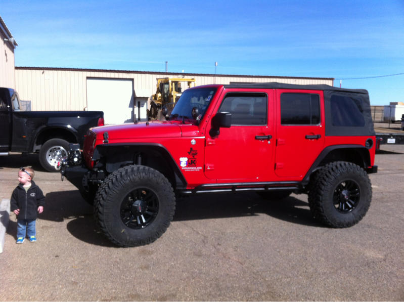

The JKS acos spacers will fix your sag. Sounds like we have the same lift. I did this on my 07 to cure the same issue I am having now. 2.5 rears, 3.5" front Clayton's.
I got my springs in tonight for my '10 but had no time to install.
Here's my 07 tho
Pretty dang level. And I carry a ToN of extra crap in the back tho
