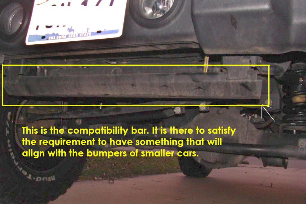

Is this the bar you are talking about cutting off?
