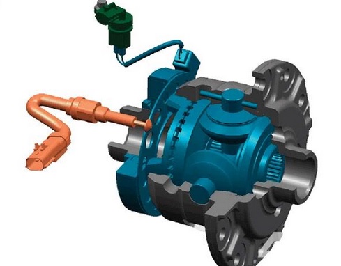

My rear locker had the same issue and eventually stopped disengaging. It got annoying manually disengaging it after each weekend of wheeling. The issue is the sensor/plunger kept getting jammed. I pulled the plunger/sensor (in orange below) and plugged the hole in the housing. Locker works like a charm. When the locker is engaged the dash light will flash as if it's not engaged because the sensor is missing but that's not an issue. If you have a need to use lockers than you should know when they're engaged or not without the light telling you. The installer most likely messed up your sensor.

Thanks for the reply. The Dealer replaced the plunger and no further issues.
