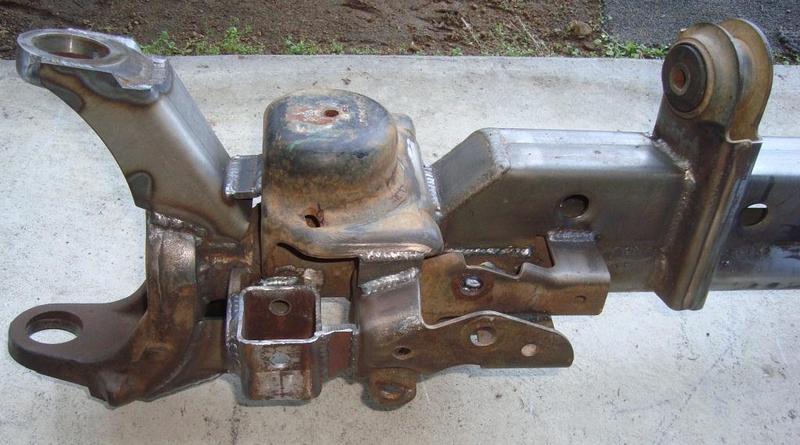

Know that getting a TW driveshaft is not going to fix your problem.
With a double cardan ujoint up at the transfer case it needs to take up all the driveline angle, meaning the front ujoint angle must be 0° to the pinion or vibrations can/will occur.
I installed a Rubicon Dana 44 in my Sahara, my fix was to cut the welds on the "C's" and twist them so I get the same results as a Prorock44(yes not as strong)
<img src="https://www.jk-forum.com/forums/attachment.php?attachmentid=383250"/><img src="https://www.jk-forum.com/forums/attachment.php?attachmentid=383251"/>
Nice Job first of all... Second, out of my skill set
