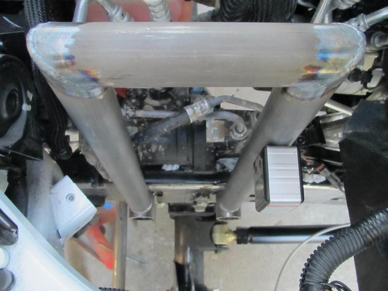

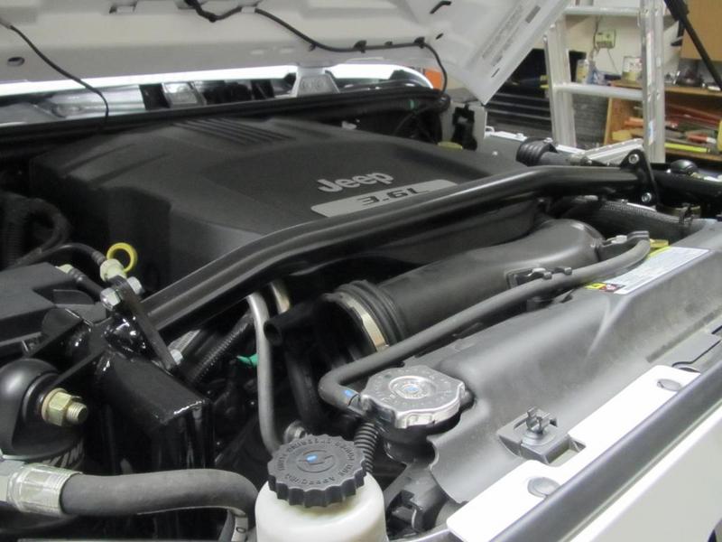

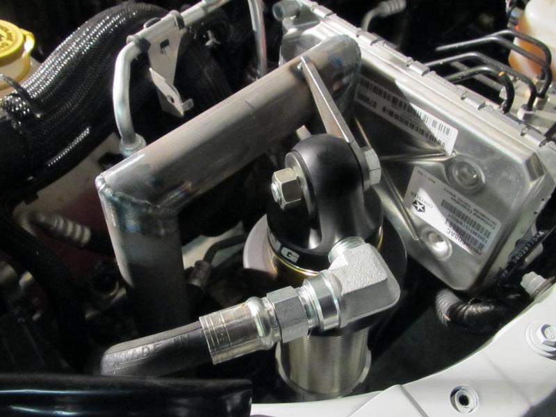

I can say first hand,, towers in the JK are a Pain in the ars! Had to put the computer on its side,, ditched the windshield washer fluid reservoir, no more air box(had to go K&N),, and the crossbar is seriously tight. But,, it is soo sweeet!
