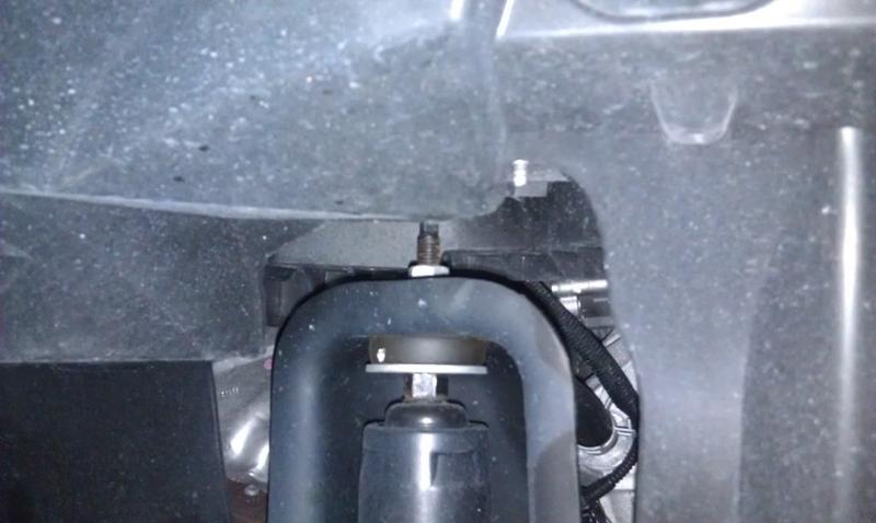

Like the others have said "cut that plastic crap out of the way". Well, they might not have said exactly that.
Name:	Right Front Spring 1.jpg

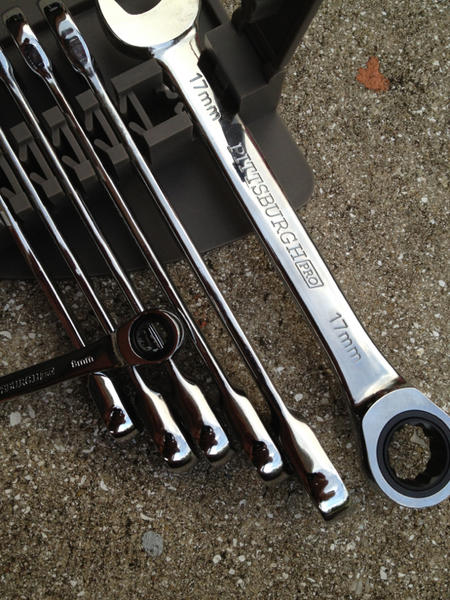

The drivers side can be done like this
Please tell me how you can do the passenger side. You cannot get the wrench on the and have the wrench sticking out to hold it still while you turn the shock with vise grips so how do you do it?
Old Sep 17, 2012 | 03:18 PM
AlphaRomeo15's Avatar
Posts: 156
From: Cape Coral, Florida
This is the type of wrench you need not a sockets. Make sure they are the ratcheting kind or you will bust your knuckles from taking the wrench on and off the nut. I don't remember what size you need.
