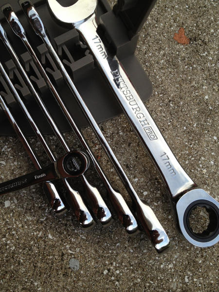

This is the type of wrench you need not a sockets. Make sure they are the ratcheting kind or you will bust your knuckles from taking the wrench on and off the nut. I don't remember what size you need.
I have these wrenches.
The passengers side will only allow you to put that wrench on if you point the wrench to the front of the Jeep, Then when on you cannot turn it at all to tighter the nut. There is just enough room to get the wrench on the nut.
Drivers side was easy
