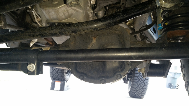

Originally Posted by danimal863
I have got a 2015 JKU Sport. I recently (3-4 months) installed the Rock Krawler 2.5 Stock Mod which comes with an over-sized adjustable front track bar.. I have taken it off road twice since. This last outting was muddy...all this central Florida rain. Anyway, while washing the mud off the under side, I noticed the front track bar is rubbing the front pumpkin (differential cover). I placed a pair of ramps, your typical black plastic ones from parts stores, one on the driver side front and one on the passenger side rear to replicate a "flex" in my driveway. It wasn't quite touching yet, but was within a .25". Any recommendations, drop brackets? or can the bar be rotated slightly out to clear the pumpkin without effecting geometry?
Sorry if there is a thread already started about this, I couldn't find it.
Sooo is my TB upside down?

Old Aug 10, 2015 | 01:58 PM
  #28
jadmt's Avatar
Posts: 4,364
Likes: 107
From: missoula,mt
Attachment 621055
yes........................you need to rotate it up so the bend is toward the top about 15* forward
I tried to earlier, but I couldn't get the jam nut off the lower end to rotate it. So I'm going to take it to the shop and have them honor their work.
the jam nuts are beeches as the are torqued to 250 ft/lbs and have red locktite.
