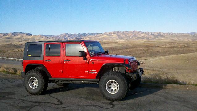

If your not wheeling to much I would highly recommend a 2.5" this is the highest you can go before getting real expensive any higher you need drive shafts control arms and so on. Here is my Tf 2.5" coil lift with 37s.

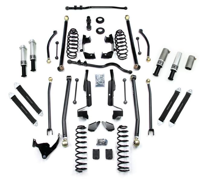

For trips out to the hunting spot you will definitely want the Teraflex LCG Prerunner kit. It has just about everything you need. You will be able to go like hell without worrying about them bumps.

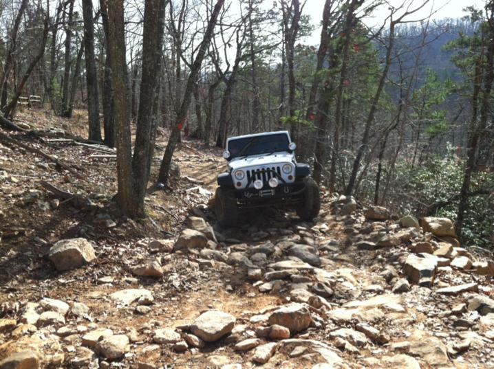

Yeah if ur not doing hardcore off roading 2.5" lift is good as it doesn't mess with drivetrain geometry and steering needs. Here is mine lifted 2.5".

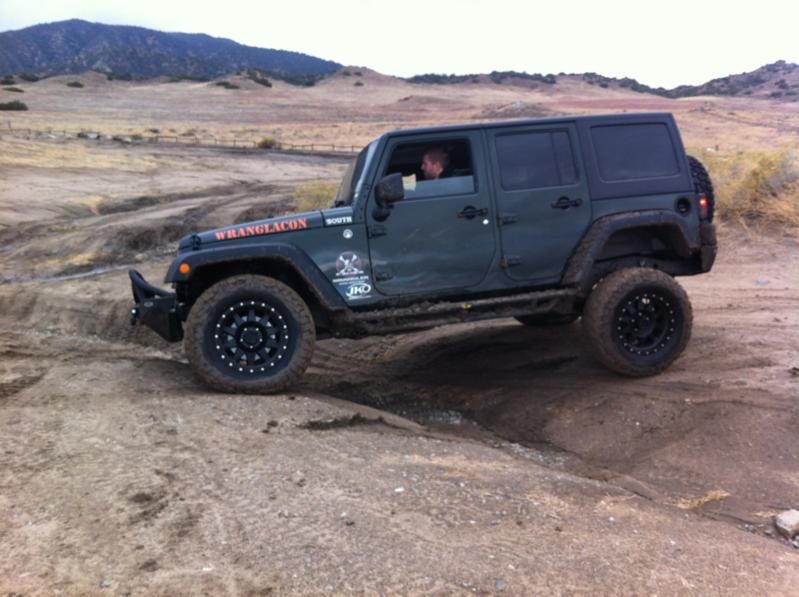

Teraflex 2.5 coil lift will get more than 3" and clears 35's at full flex
