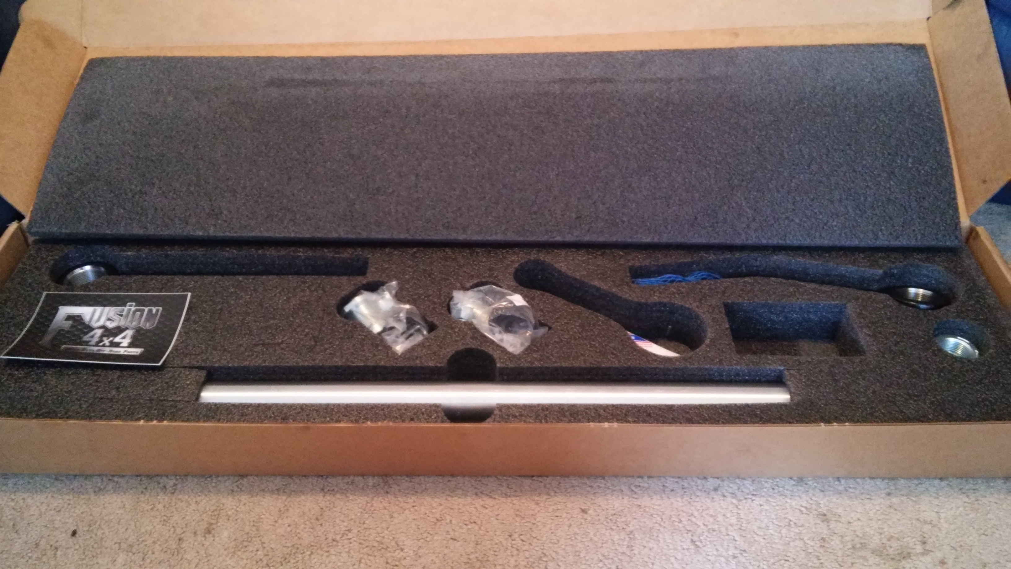

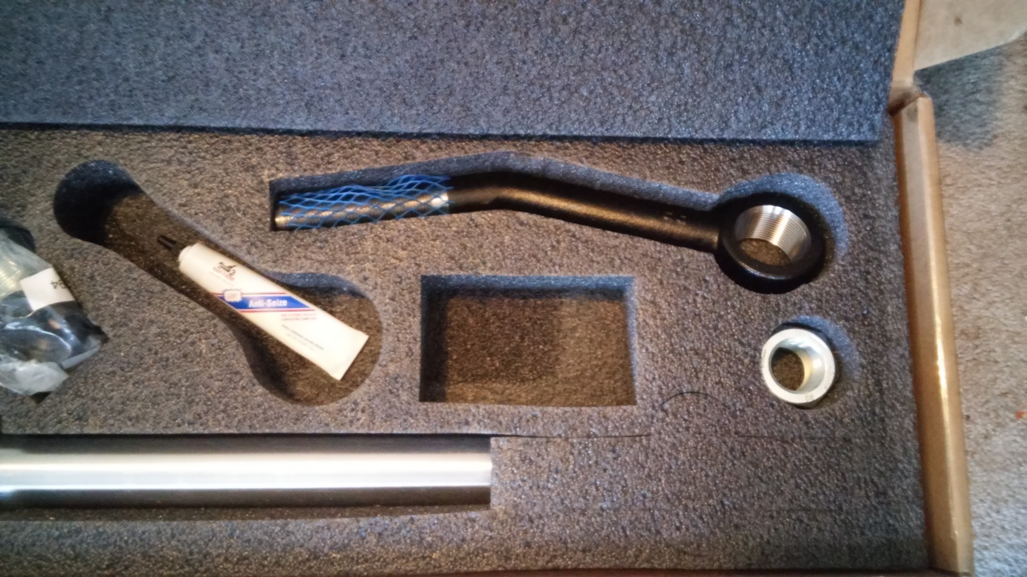

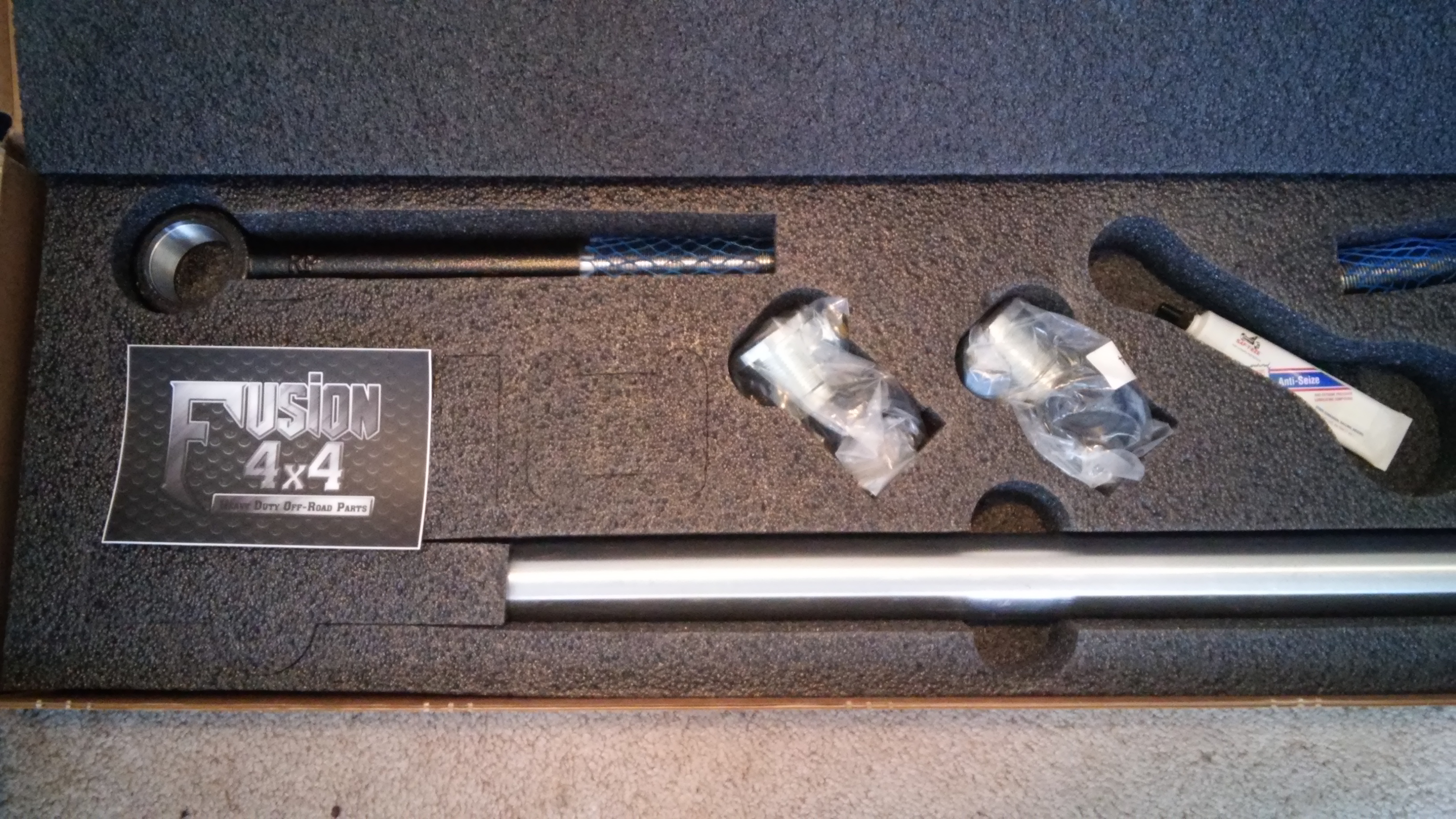

The packaging was great. The TR and DL came in their individual boxes with all parts thoroughly packed and secured in foam.

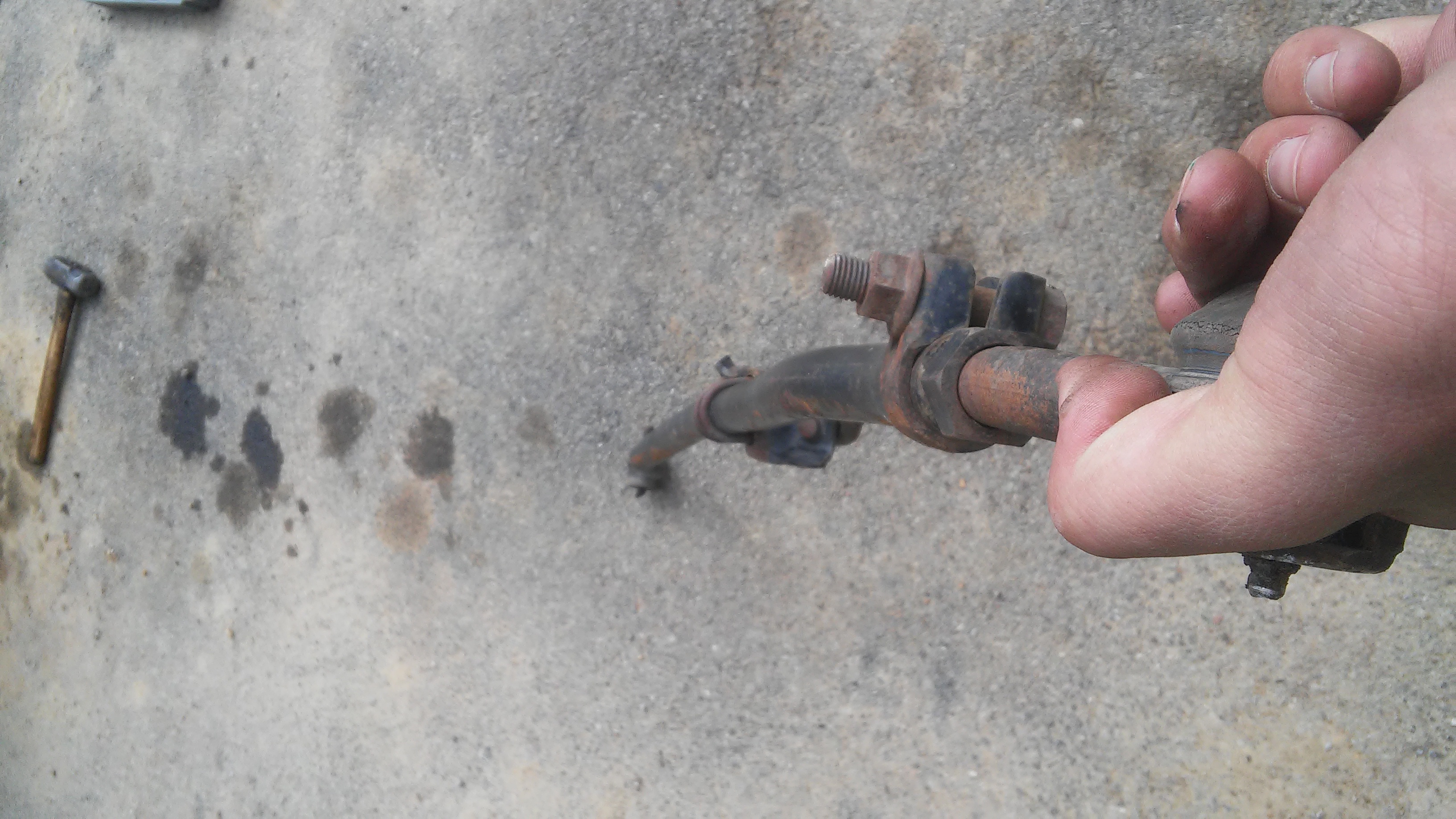

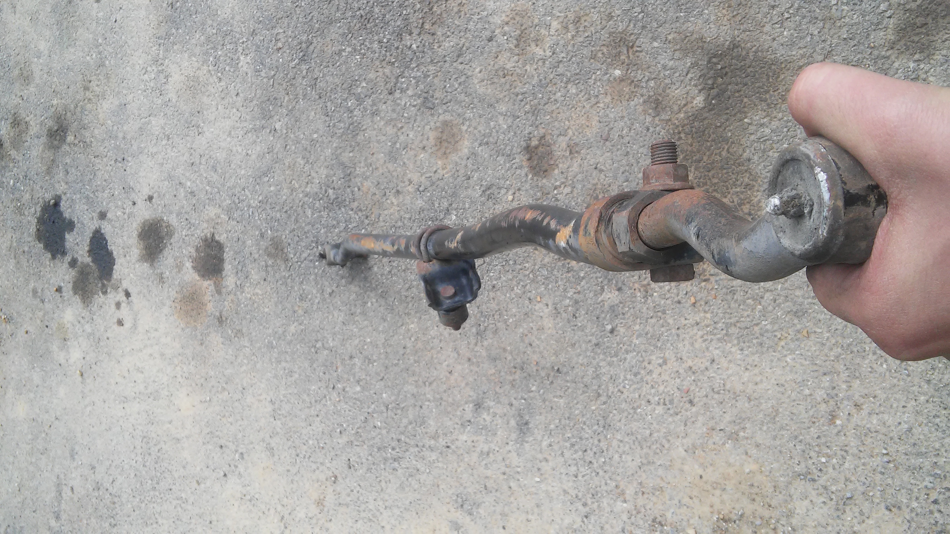

Next removing the TR and DL. Not really a big deal, just remove 4 bolts and knock it out. The TR came out with a little convincing of a bfh. The DL on the other hand was a PITA, the end at the pitman arm was spinning with the wrench and the hex key hole was stripped. So time to take a grinder and cut that sob out.
Yea, my TR was straight at one point in its life...I think.

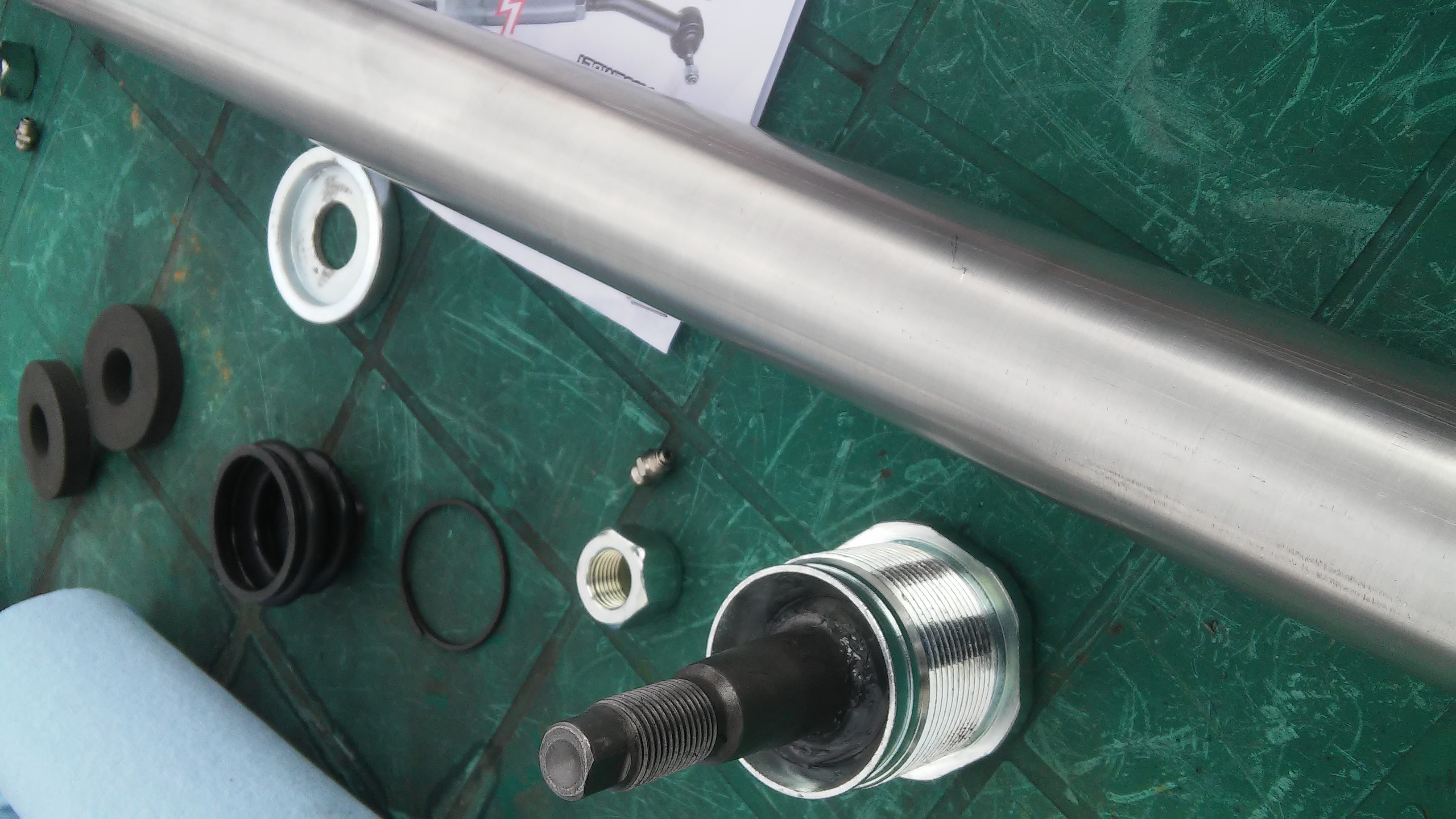

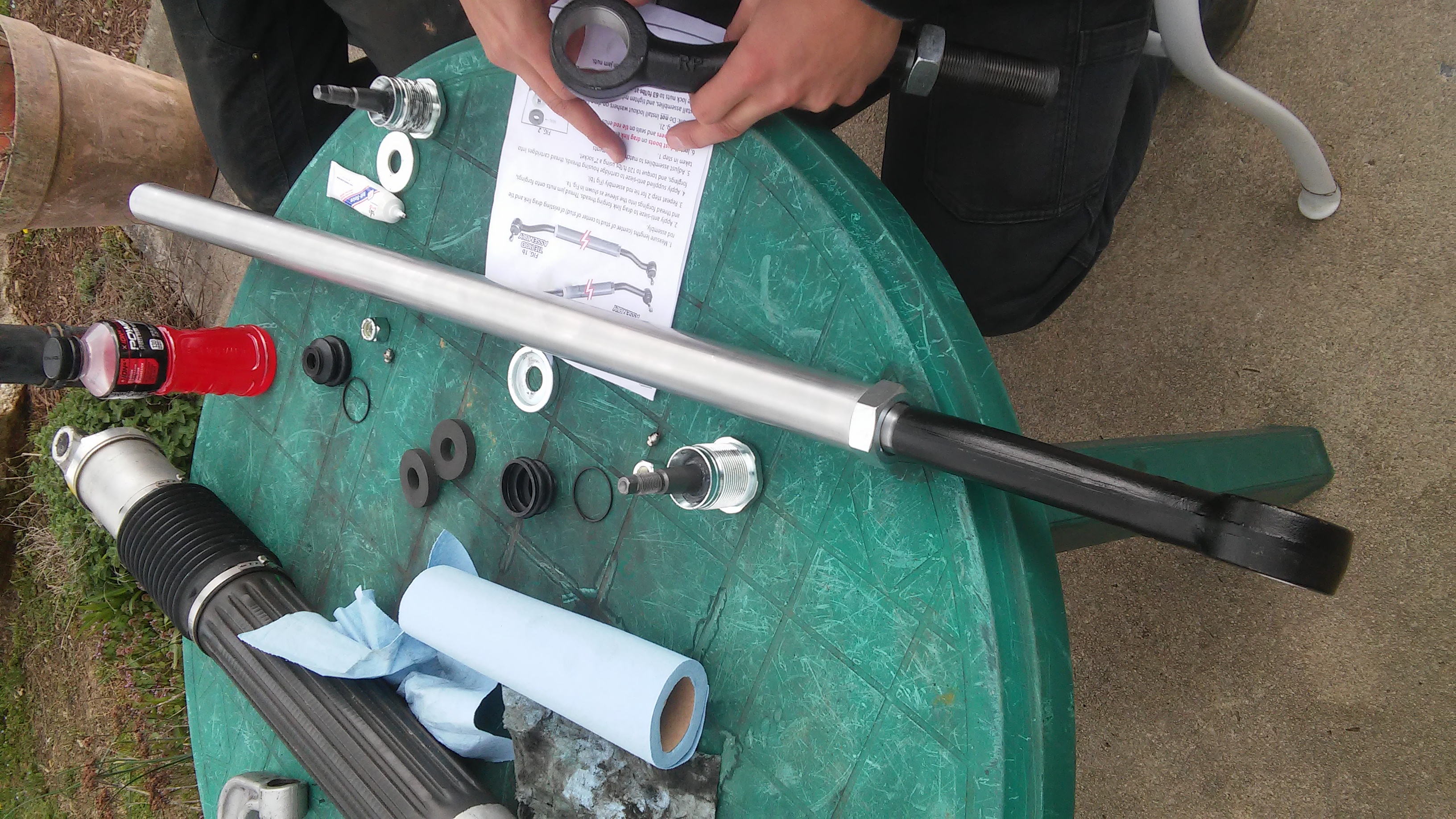

Next assembling the Fusion Steering Kit. This was actually really easy. Just follow the instructions, apply some anti-seize, and take your time. Also make sure on the DL you put the end in correctly on the knuckle side so the bend is out. Got it all assembles and the was thinking "this doesn't look right". But, just quickly flipped it around and problem solved. The ease of installing the TRE cartridges is actually really awesome. If I blow an end, I can install a new cartridge without effecting toe or my alignment. The hardest part of the install was finding a 2" 6pt socket to torque the ends to 120 ft/lbs in the forgings.
Comparing the old TR to the new TR. This thing is massive!!! 1.75" diameter solid 7075 aluminum for both the TR and DL. Honestly makes the rest of my axle look small.

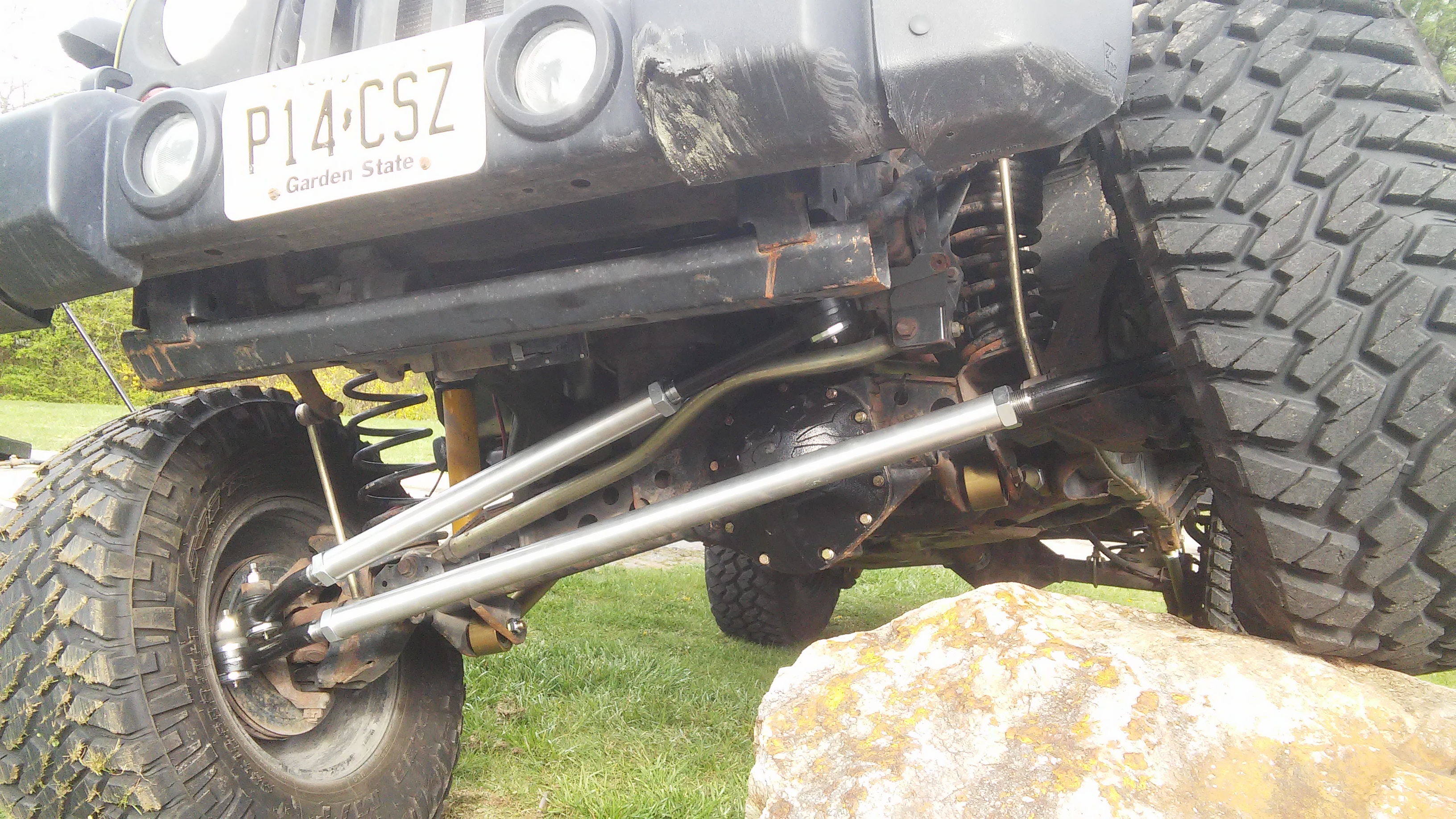

Did a little flexing at a friends yard to look at clearance. Doesn't seem to be a problem. They designed the kit to work on everything from a stock JK to custom fully built axles and beyond.

Man that looks like how Aircraft parts are packed!! Man you really beat the Sh*t out of the old one lol...... Eventually I'm going to do hydro steering setup but this is a really great write up

Is it just my eyes or did you bend your driver side sway bar link?
