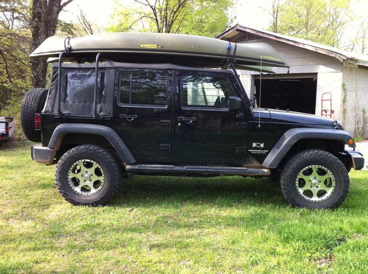

I had a 4 door soft top and recently traded it in on a 2 door rubicon soft top. I bought a Lange rack because it required no drilling. The back rack attaches to the spare tire. The front is attached to brackets that mount using the windshield screws and the brackets have a place to mount mirrors when your doors are off. The problem I had was that my kayaks are 12 feet long and on a 4 door it's about 11 feet between the front and rear. So I found another option for the rear - it's a high rock and it attaches to the tub with clamps over the side. You have to cut a couple of short pieces out of the plastic top clips for it to go through the soft top - not the top itself, just the clips. It has 2 hoops that slide into the channel on the bracket and you can get a basket to use with it. On my 2 door I just use one hoop most of the time. I can take the front and back off in less than 5 minutes and can drop the top with both sides in place. It's a hybrid but it works for me. Here's a shot of it on my JKU.
