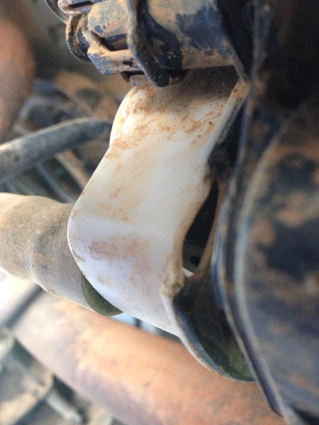

Could this be the problem? There is a cracked missing part on the front of the white plastic

Yes that is probably the issue. The location sucks. I covered mine with silicone after epoxying it back together and Zip tying it back under my Jeep

That is a shitty design of jeep. Should have put it under a skid plate or something. Anyways ya that's the prob I'm going to epoxy it back
