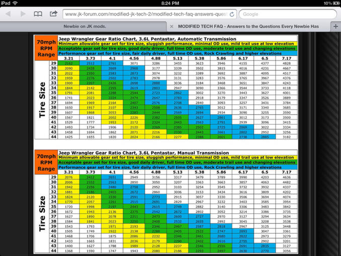

Found this chart, good info even though it is for the Penstar.
Attachment 373681
Chart for the 3.8L:
