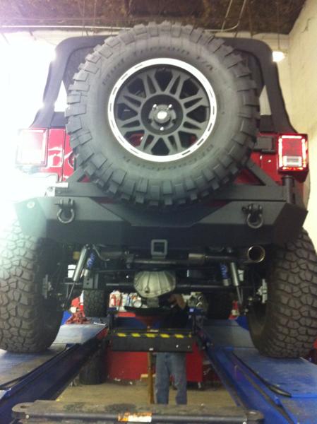

I have g2 Dana 60 rock jock with 538's on 37's and I like it alot gas milage sucks but it's a jeep right ? Just waiting on a tuner I have a 2011 so none available yet !! Guys at 4wheel parts did the work
