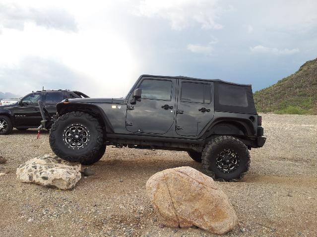

5.13's with my 37x13.50x17 Nitto Mud Grapplers. Add Superchip Flashpaq with 87 or 91 tune to breathe some life back also.

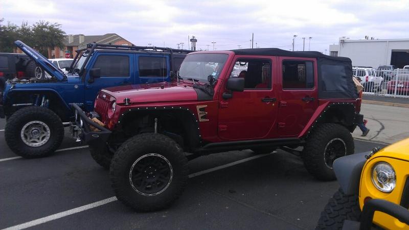

I have 37's with 538's perfect combo with a pro cal , Click image for larger version

Sent from my HTC_Amaze_4G using Tapatalk 2
