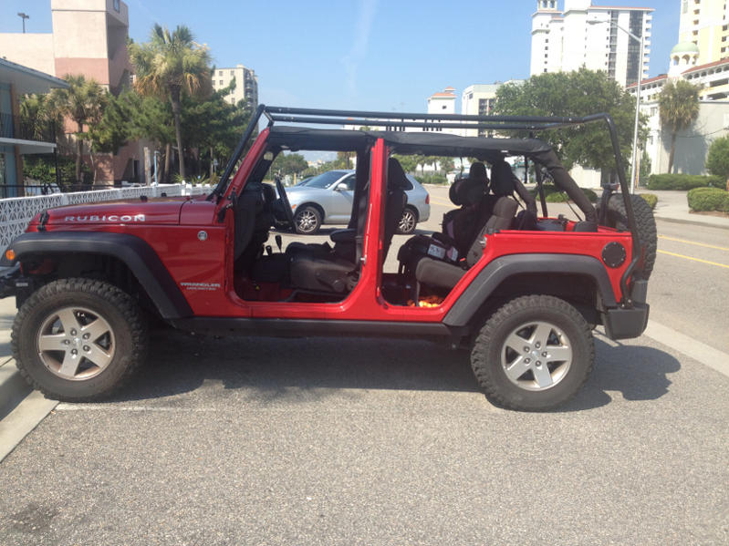

I have the performance leveling kit on mine and I love it. It rides good and looks good with stock tires. my wife has the spacer leveling kit and she is happy as well. I'm mounting my 35x12.50s on Friday if my spacers are in.
Here is picture with stock tires
