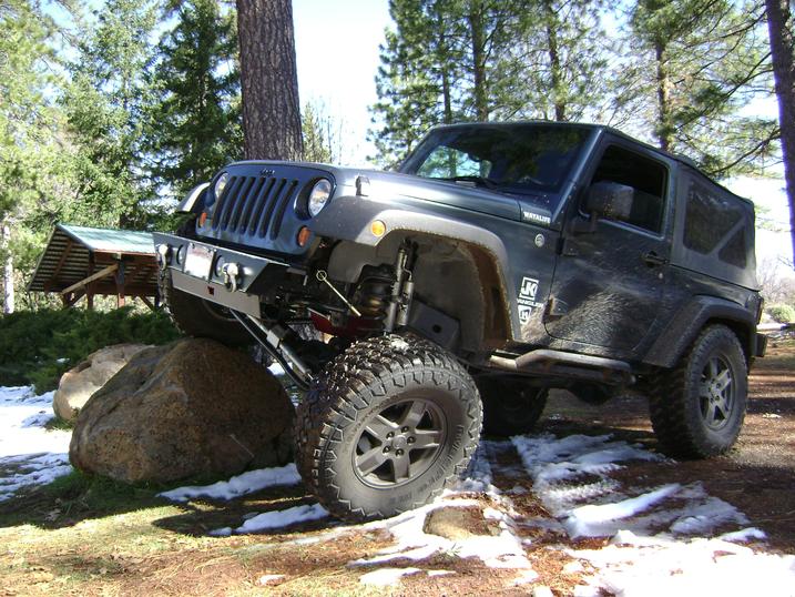

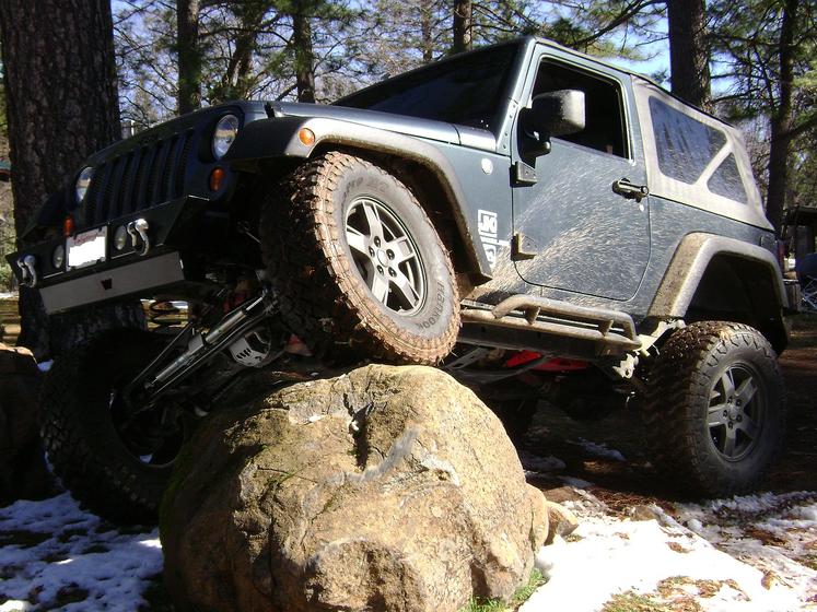

I'm running 3.75" lift with 35's and oe shafts. works great for now, been a yr. What all does the lift you're looking at come with?
