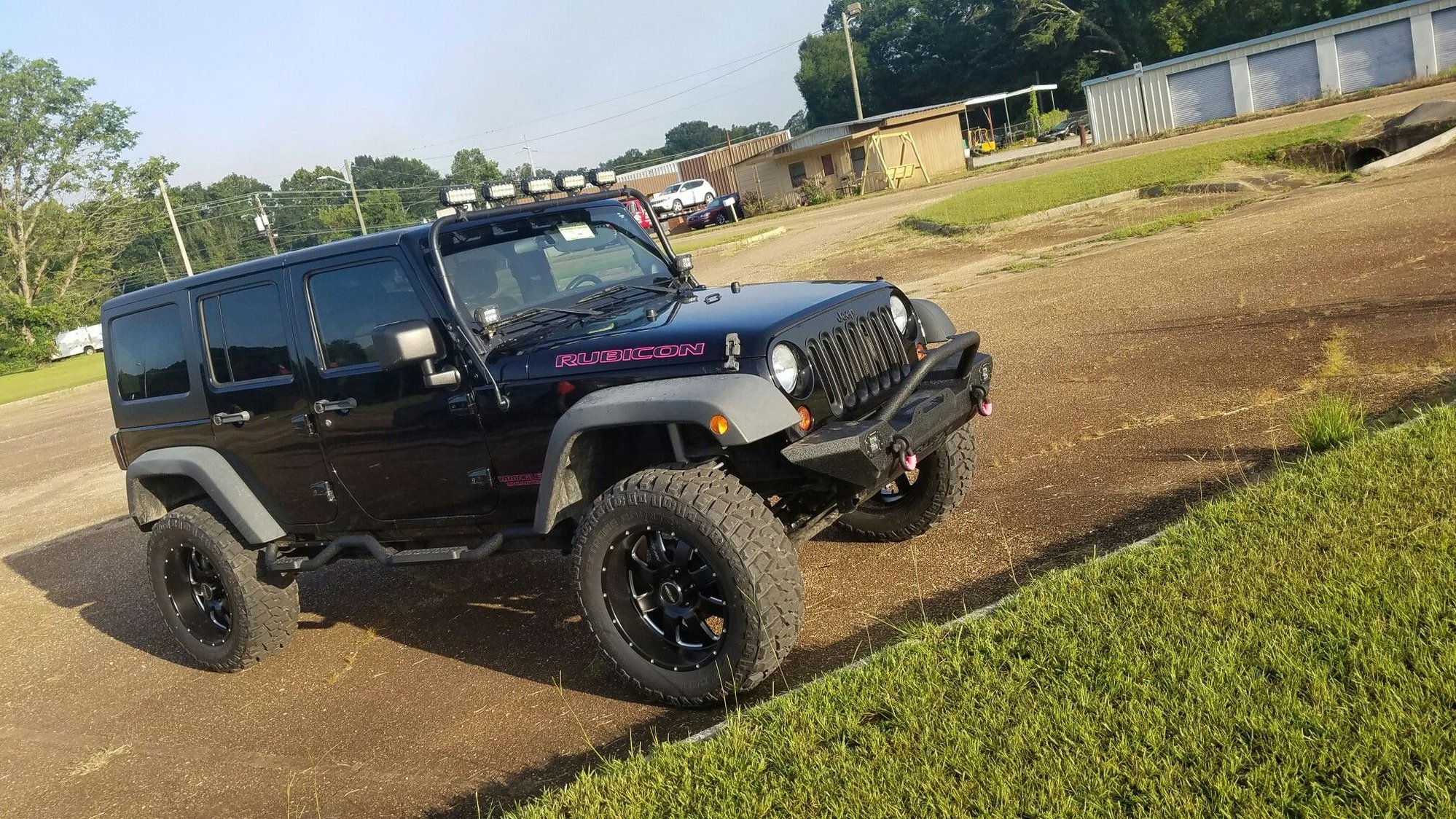

Good evening. This is my first post but I been reading alot. I have a 2011 Jeep jk unlimited Rubicon edition. I purchased it with 95000 miles in stock form. I instantly installed a Rough country basic 4in lift ( realized that was my first mistake ). I then installed 35*12.5*20 DC extreme country tires on Pro comp wheels. It rode good ( for a Jeep) just a little darty at times but drivable. Then I guess (the factory) ball joints (death wobble) went out at 104k miles. Couldn't find anyone with the Terra flex joints so I installed the synergy joints. That's where the problems started. It started getting real crazy driving. Drifting, fighting steering wheel, darting, etc. I started researching and read to check the caster well it was at 2.8 degrees and the simple RC lift wouldn't allow me to get more than 3.4 degree of caster due to the POS bolt adjuster it came with. So I ordered a set of Rock Krawler upper and lower control arms and a Rock Krawler Trac bar. Got the caster to about 5.2 degrees ( top leaning back) with ease. Still rode like crap but figured the alignment might be off some. After a trip to a respectable alignment shop they said it was spot on besides the left tire was just a grunt out (but still in the green). Surprised since all I used was a tape measure. They couldn't get it to adjust due to the tie rod was ceased and would not move. They said everything looked good. But it still takes 2 lanes to drive 75% of the time. I took it to a buddy's shop to get a second set of eyes to look and see if he could see anything Me or them over looked. Only thing we could find was the drag link looked tight with little play but would flop up and down with ur hand as well when u wiggled the steering wheel it looked to flex in the middle a little ( idk if that is normal with factory). And the tie rod had the same movement besides the flex just the up and down movement.
The reason for the novel above is to get you up to speed with what all I have done. I have drove all kinda off road trucks from a jacked up pieced together lift on a 78 Scottsdale to a ragged out lifted CJ7 to a 06 Dodge 2500 This is my first experience with coil springs and 4 link. Nothing has drove as crazy as this. My biggest concern is this is my wife's DD until I buy her something else next year. So gotta make sure she and kids are safe. Any help would be nice.
