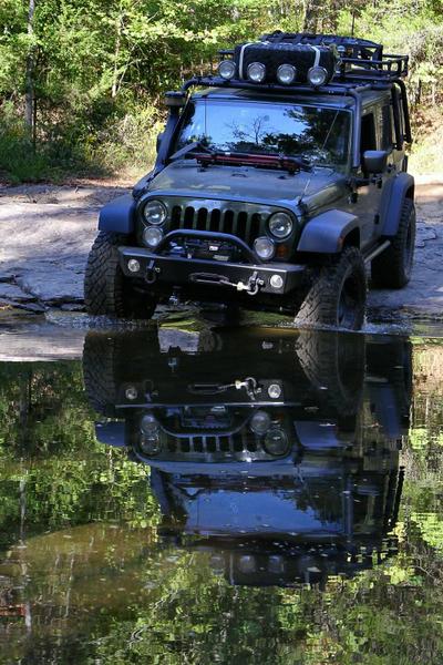

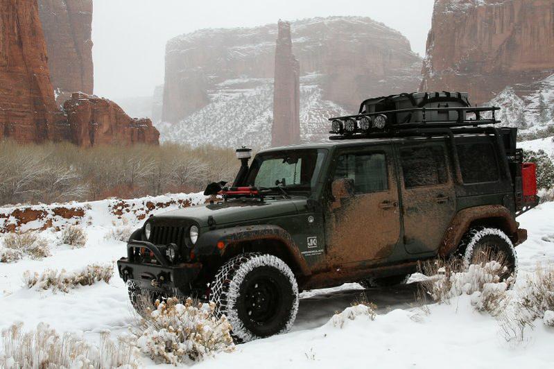

I am running 35s, 2.5" TF coil lift, OME HD rear springs with stock, untrimmed fenders. Did trim pinch seam to stop it from rubbing, and do have RK rear spring wedges, which give a slight increase to lift. Otherwise, no rubbing with 4.5" backspace wheels. And I run very heavy ...
I run the OME HD springs it's more like 3.25" lift with bumpers/winch. Also, you have TF coils which I know one of my buddies got close to 3" of lift with bumpers/weight on his JKU. The springs you are running are Heavy duty (OME & TF) and are great springs vs just the stock springs which sag with added weight. Are your tires a true 35? That will make a difference as well as I know some 35's on the market run like 33.5".
Running the OME HD coils with bumpers & winch gave me an just a tad below 3.25" lift. Running the Cooper STT 35's (actual 34.6") mounted on a 17x8 with 4.6" BS rubbed on my Rear stock fenders fully flexed out and thus the reason I went with flat fenders. Yes I could have added a 1/2" bigger bumps stops or added rear control arms to push back the axle to the center of the wheel well to avoid the rubbing on the stock fenders.
All good questions and points. I would encourage anyone interested in what I'm running to click on the link in my signature--it will take you to a fairly complete list of my current configuration. I should emphasize that when I remove the hardtop and the expedition gear, the OME rear springs are too high. I replace them with the TF 2.5" springs. As I indicated: My Jeep is VERY heavy; expedition rigs get that way ...
Note that in the above picture I am not loaded up for a trip. If that were the case, there would be another Alu-Box on the trail rack, as well as a 5-pound propane bottle. And perhaps yet another one on top of the Jeep, as well as the second spare.
I know there are plenty of folks running "2.5 inch lifts" and "35 inch" tires, and they are not trimming/replacing their OEM flares. The exception is far and away someone who puts such a rig together and has problems with rubbing that do require flare changes. Unless one happens to like the look of flat/trimmed fenders (both win the "goofy looking" award in my book), I would suggest put the rig together and see if it works. Then decide what you should do. Everyone's configuration is going to be a little bit different and what works/doesn't work for someone on this forum may be the exact opposite experience for you.
