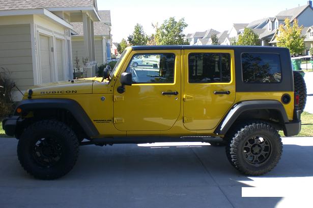

I have the Rough Country 2.5" lift with the RC 2.2 shocks. I like it a lot--the ride quality is virtually the same as stock. The one annoying problem with this lift (as with all BBs) is that the steering will become "flighty". The corrective action is supposed to be more caster, which you can get after replacing the control arms. I have new front, lower control arms in the garage waiting for me to find the time to install them. So, as you consider price and how much ride comfort and articulation you want, consider how important the steering quality is to you. For me, that is a lot more important than what new springs would have given to me. Here are a few pic's:

Great lookin' Jeep! That's almost exactly what I'm going to try to build out.
