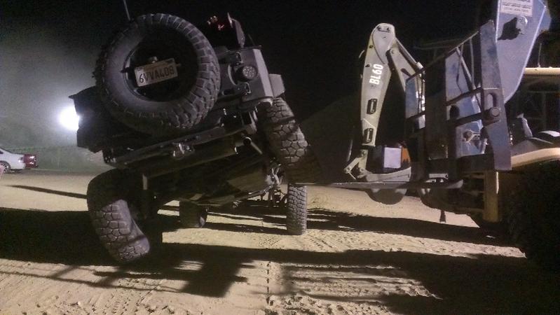

Nice choice on the lift, I have the 2.5 also but I have bilsteins for a 4" lift on my '12 4dr rubi. I went with a J.E.Reel 1310 shaft and haven't had any problems yet..even with 37's. The good thing about Reel shafts is that they use neapco u joints instead of chinese spicers joints. Im also still running the factory rear shaft with no problema yet after 29k miles
