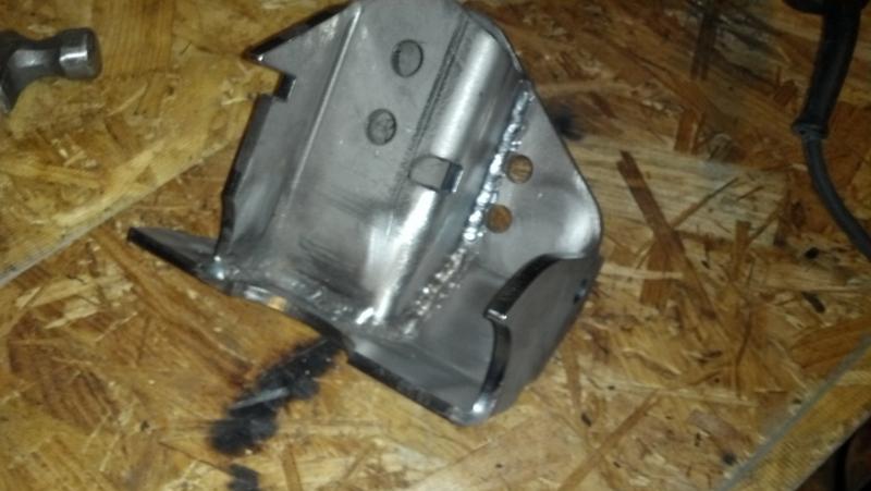

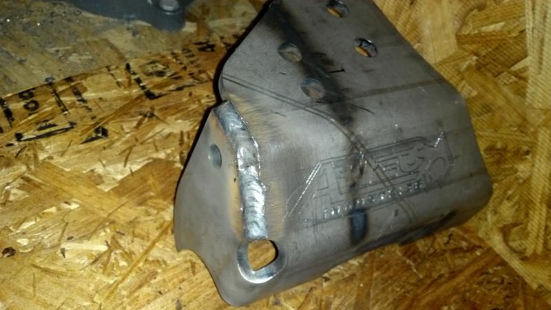

I wouldnt do any axle work with a any 110v machine, let alone an arc welder. Harbor freight is running a promotion for their 220v 170amp mig for 169 bucks. Its what I bought after I outgrew my lincoln 110v and it is a fantastic machine for the money. Ive taken on a bunch of projects with it and it has excelled in everything ive thrown at it. I'm a little weary of any HF tools, but this machine is a great buy. Here is some of the work it can do on 1/4" material
ID:	395672Click image for larger version
ID:	395673Click image for larger version
