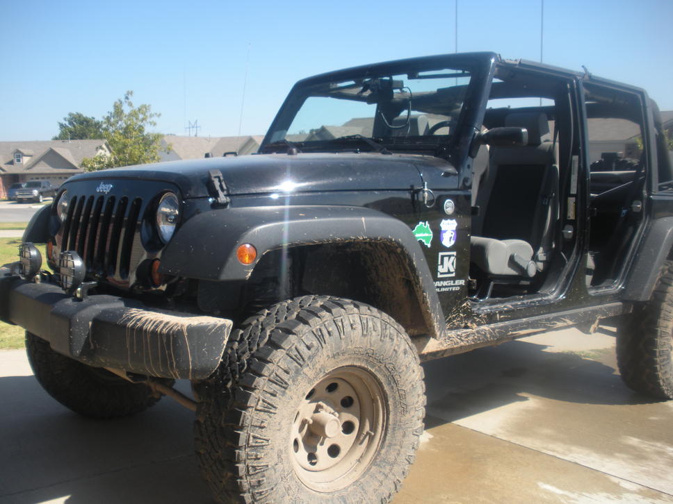

Your setup sounds a lot like mine. I am running the Pro-Comp series 97 rims, the Goodyear DuraTrac 315/75R16 and the RC 3.25" lift.
She handles perfect both on and off-road, you'll love your new setup

Have you removed that plastic air dam thing on the front bumper? I managed to leave mine on for 3 years, and only just recently removed it when I upgraded to 35s. At full turn my tires were rubbing it. No big deal, I just removed it and haven't looked back.
I have only minor rubbing while at full flex, nothing big, only my tire making minor contact with my fender. I know a guy who has a TeraFlex 2.5" coil lift (and heavy loaded down with LOD bumpers) who is running 35" MTR Kevlars and he doesn't seem to experience too much rubbing either.
So, I'd imagine you'd be good too.
