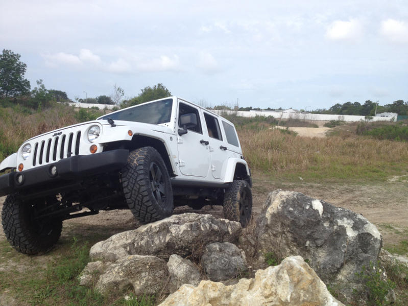

Here is mine on a 2.5 in TF coil lift ad spider trax wheel spacers
275/70/18

Edit 275/70/18
