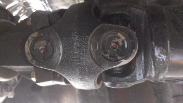

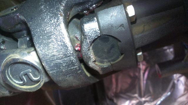

Yes I can give me a few mins and ill go crawl under there and point them out. Mine were covered with paint. If I remember correctly there are 3 on the CV joint. 1 on each u-joint and 1 for the center ball.

They are not standard zerk fittings they are little ones that use a needle nose adapter to fill.

Here are the pics I've been meaning to post. Also I tried to hit the center ball zerk and unless my fabricated needle adapter will work looks like I'm gonna have to pull the DS to grease it. This is the CV joint on the rear shaft. I can't seem to locate and zerks on the front shaft CV joint am I missing something? I seem to remember them when I installed it.
