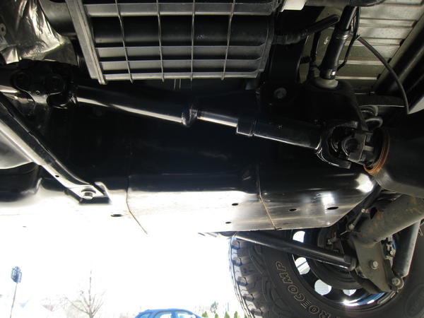

Recognize this?

Nice! And looks like very nice driveline angles as well!
