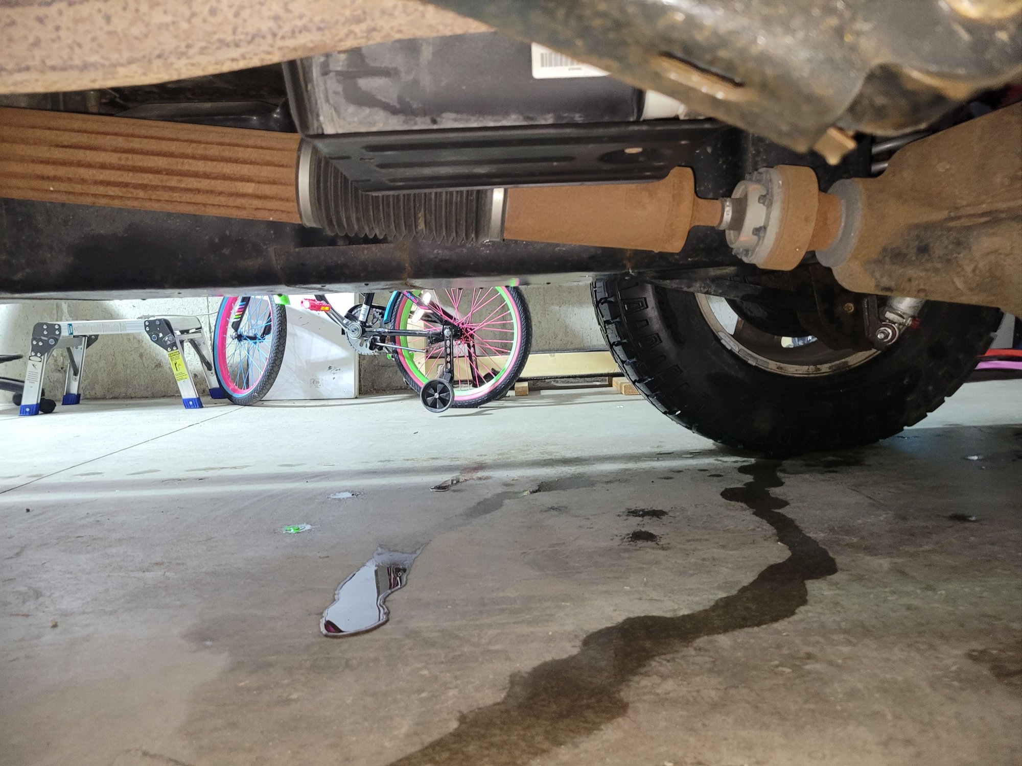

Here's pictures of my rear control arms as they currently are, plus the driveshaft. I was hoping for an opinion on my pinion angle, since that might determine the route I take.

I’m not a fan of u-bolts on the axle. They just give rocks or other stuff on the trail something to hit. And at $190...!!! Wow! You’re better off going with resharps advice on a $20 wedge. If you get adjustable control arms then you can just tilt your pinion angle down a tad and you won’t need to do anything. Your pinion angle looks fine too by the way, but even angling it down a little with control arms will be good too.

Yup, one or the other, but both is redundant for your set up. The upper arms will allow you to tilt the pinion down and should provide the clearance you need if you go that route.
The issue most of us run into is pushing the axle back with a full set of rear control arms. This gets the axle spring perches much more out of alignment to where repositioning the perch is the real solution.
On a side note, I'm surprised the boot at the spines on that rear DS isn't shredded yet. The silly evap skid right next to it usually chews that up quickly. Have you or the previous owner repositioned that over a bit? Maybe the jeep hasn't seen much time off road? If you want a fun afternoon task one day, you can remove that rear DS and flip it around. Since it has CV joints on both ends it can be mounted in either direction. Oriented the other way gets the boot further away from that evap skid. Tereflex also has a video out there showing how to easily move the skid just a bit further away from it.

I think with the options I have, adjustable rear control arms are a good choice to correct pinion angle. From what I've read, it can also help with rear axle dog tracking...which is something I feel I'm experiencing. Mostly, I didn't want to go to the expense and trouble of installing them only to find that it negatively affected my pinion angle from where it's at right now.
Then, I could probably assess the situation regarding the rear spring bulge and possibly get some correction wedges if necessary. Also, about the adjustable rear control arms, sorry if you already explained it, but I could get away with getting adjustable uppers with the stock lowers? Or would there be any benefit to just getting upper and lower adjustable rears?
Also, I haven't touched that evap skid plate, but thanks for the headsup. I can't say whether the PO messed with it, but based on how straight everything looks underneath the rig, I'm guessing it's seen very little if any offroading. I'll see if I can make sure that plate doesn't interfere with the boot, though.
