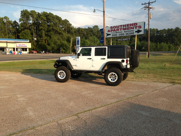

So my jkru(14). Handles weird going down the hwy at 60-70 mph I am always over correcting and don't feel safe It has a 6" lift and 37's. is this normal I look like a drunk driver hitting the lines on the rd Any thoughts

Do I need to just get the feel of it I had a Sahara about 5 years ago that had 3" and 33's and drove nothing like this one

6" is a lot, what specific components do you have? What are the alignment specs? How parallel are the drag link and trackbar? What pressure are you running the tires at? etc...

drag link flip with adjustable control arms if you don't already have them.. yeah, that seems little over the top lift height.

What kind of lift are you running? I agree 6" is a bit high. A lot of different angles come into play at that height. I would bet more than one is off.

I agree that it might be to high of lift but I absolutely didn't want any rubbing with out cutting flares

That's where bump stops come into play. There's a lot of good information on this forum, I suggest doing some research on suspension setup. Or you could always take a ride over to your local jeep shop and have a conversation with them about it!
