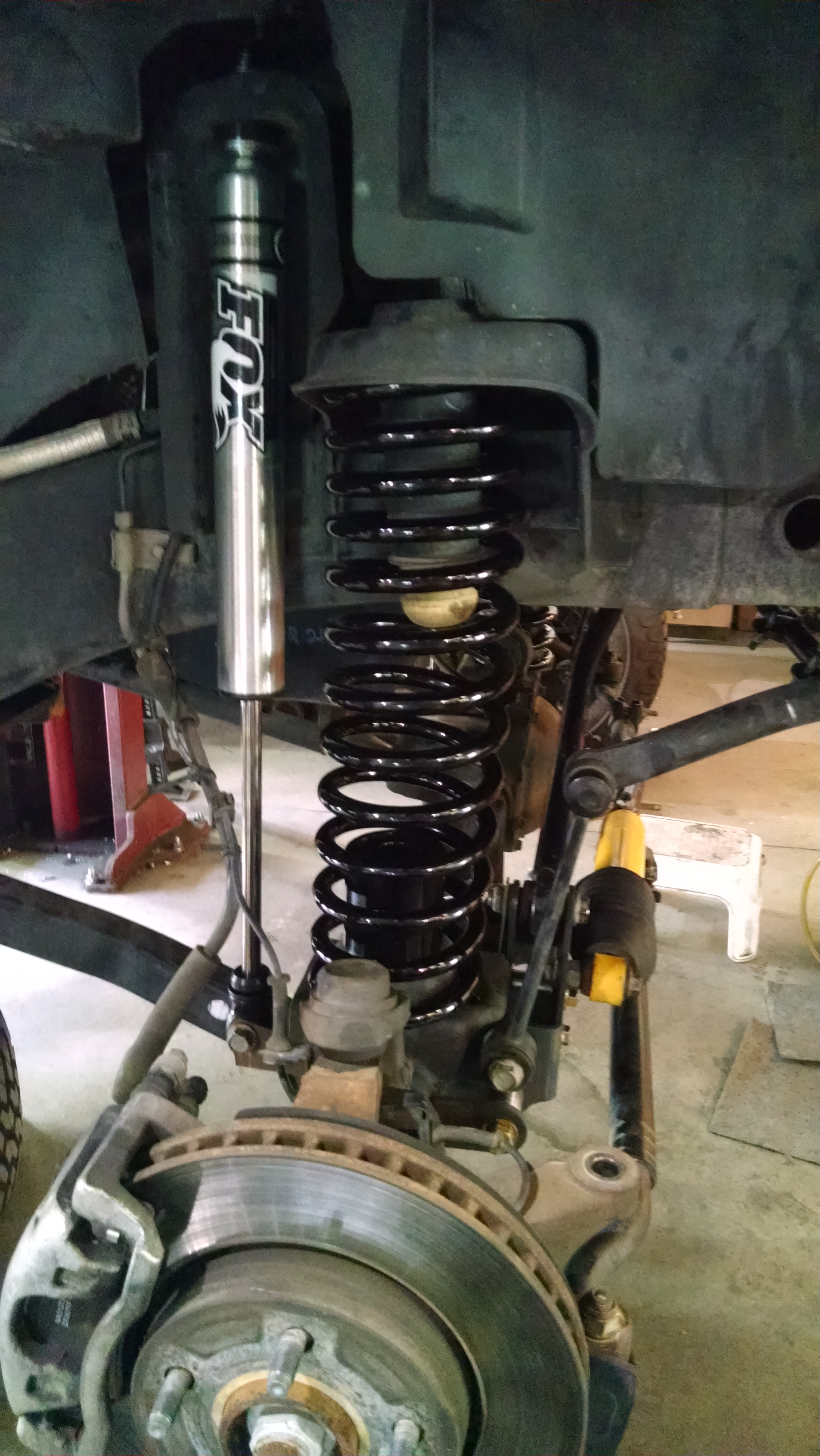

In the interested of not leaving this thread open ended, I wanted to report back with how this all worked out...
I'm fortunate to have one of the top shops in the country near me. I totally trust their advise but I also like to ask other retail-paying owners their opinions which is why I started this thread. Anyway, after listening to everyone's input here, I went in Friday morning to have the checkup on my gears and was loaded for bear with questions. I sat down with the guys and made sure to totally explain my needs and concerns. I can't express how totally awesome they were with answering every one in detail and working with me to get things taken care of at a fantastic price. I wound up going with the following:
JKS 3.5" JSPEC progressive springs w/ matched Fox Evolution 2.0 Shocks
Synergy heavy duty drag link and flip kit
Synergy track bar relocation bracket
JKS control arm correction brackets
The difference is amazing.
- The steering is so tight now, I had to relearn how to drive it and stop over correcting on the way home. I didn't realize how sloppy it was before.
- The body roll is significantly less than I had at 2.5" even though I raised my center of gravity. It is no longer tippy in the corners at all.
- The ride is night and day smoother. The cracks in the road basically disappeared. It rides like a Cadillac now in comparison to what I had.
- Bump steer is gone with the exact same OME stabilizer I had before.
- The pull to left I had is completely gone. I can drive forever straight as an arrow without touching the wheel. (Yes, I tried. lol)
- The stance. It's killer with those 35's. Perfectly proportioned in my opinion. I'll post some decent pics when I have a minute. For now, the crappy in-process pics I posted below will have to do.
All of this coupled with the 4.88's and the Black Magic/Centric brakes turned out to be exactly what I was looking for. I've realized since this was completed that the reason I was in such a hurry to give this one up is because, even though I thought I did, I didn't enjoy driving it. Now I don't want to get out of it! It's still going to the wifey eventually but it may be a little longer.
I'd like to thank everyone who commented and PM'd me. It really helped a lot!
P.S. I taught the wife the Jeep Leap. So far, no bitching. lol
