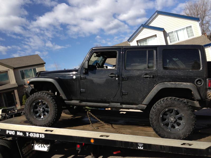

Well of she goes to the dealer!!!
Hopefully they have a quick fix for this!!!
Sent from my iPhone
