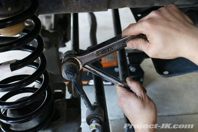

Are you talking about the swaybar links. On the top of the links the is an inside nut 19mm, your out side nut is 18mm. You have to hold the 19mm to tighten the 18mm.I'll see if I can find a pic.
Old Aug 7, 2009 | 09:37 PM
mkjeep's Avatar
Posts: 15,665
From: Hammond Louisiana

I thik he maybe confusing the trackbar and swaybar.
