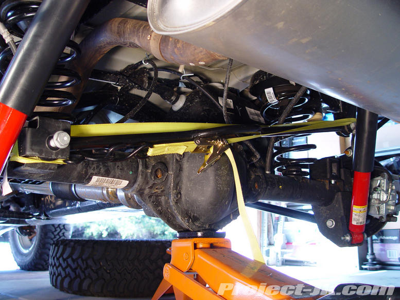

alright. but more important. how do i get the trackbar bolts to stop spinning so i can tighten them on so i can even drive it down the road to the local shop....towing costs an arm and leg
Old Aug 7, 2009 | 09:28 PM
mkjeep's Avatar
Posts: 15,665
From: Hammond Louisiana
Rachet strap like this or get someone to turn the steering wheel for you to get the bolt in.
