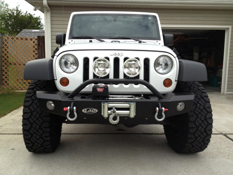

Originally Posted by rlew0083
I like my LOD mid width.
Attachment 498120
Nice !

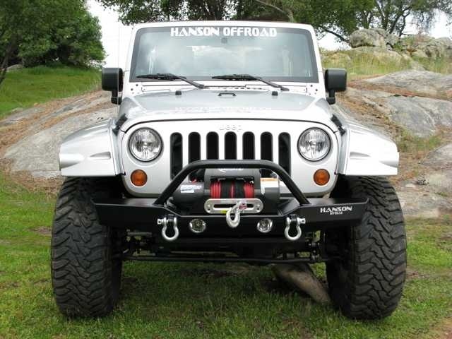

What do you guys think of this bumper, and do you see any advantages from the winch mounted on top ?
I might think it would be easier to maintain and protect the winch with a cover.
On this bumper the winch is mounted 2" lower to help the cooling flow.

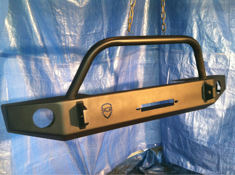

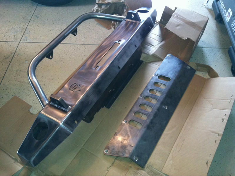

Here's my JCR Midwidth Crusader with full sunk winch.Prep.and paint for the bumper and skid took a combined 6 hours allowing for 1 hour dry time between coats.Used self etching primer with Black Chipguard paint over top.The paint is what some auto manufactures use on the lower rockers (has an orange peel or crinkle type finish) which matches the JK ABS plastic surfaces pretty close.
Was not looking forward to finishing myself but wasn't bad at all even with rattle cans.
I can attest to the quality of JCR's product....Very nice stuff.

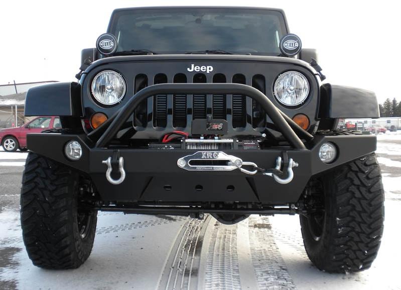

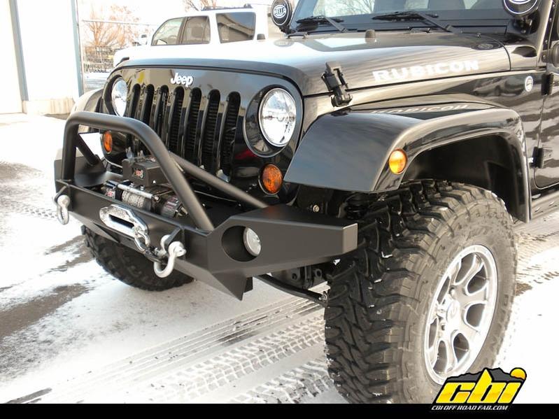

Another good looking bumper but didn't find any reviews on the web.
