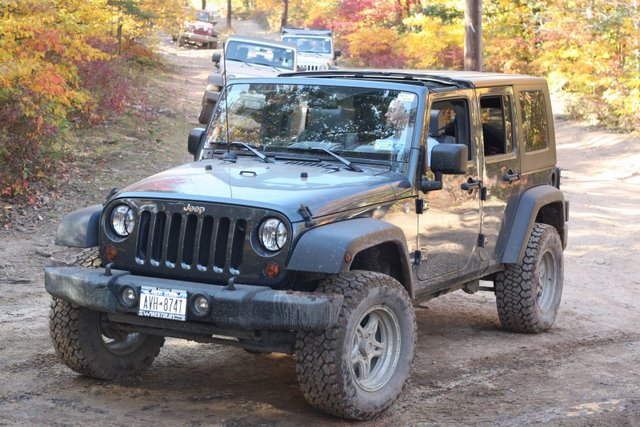

im running a Rough country 2.5 BB lift , and 33/12.5/17 dick cepeks with 4.75 bs and i have no issues at all , look at my pics, rims are 17x8.5x4.75 bsClick image for larger version
