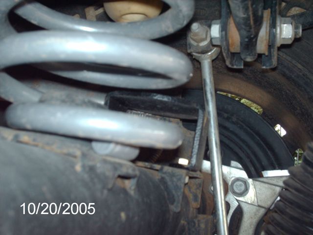

Double check your rear spring indexing.
You have a taller lift and adjustable arms so I'm assuming you rotated your rear end for driveshaft/pinion alignment. If you still have the factory spring mounts on your axle housing the entire spring does not rest on the mount anymore so.... if the spring was rotated when you were offroad the one spring can compress more now than before. It is very likely at full flex the decompressed spring is not under any tension and it is possible for it to rotate.
Check the pic out below, for max height place the ends of both springs as shown.
When I first installed my lift in my haste I installed each spring 180 degrees out from each other so with one side compressing more than the other I had major lean.
