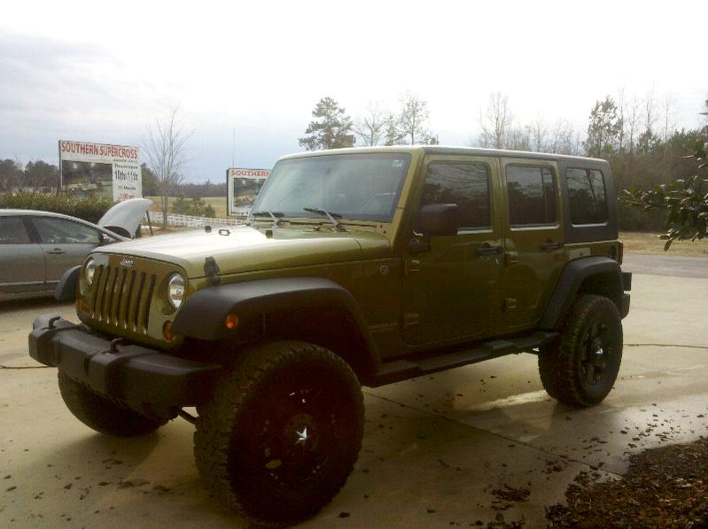

I've have a 3.5" RC with 35" tires I would stay with 4:88 min 5:13 would be better.
