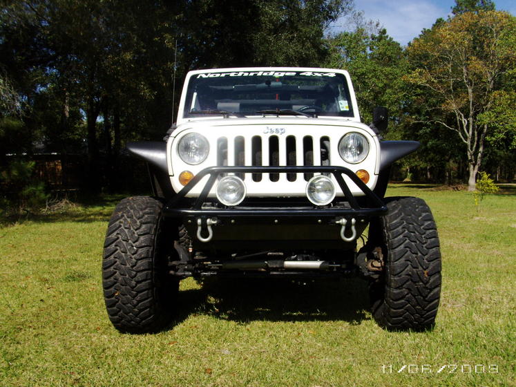

I have toyo 37x13.50x17 on my Crager soft 8's -17x8
Old Jan 17, 2010 | 08:48 PM
GoodysGotaCuda's Avatar
Posts: 3,074
From: Denton, TX
Hows the contact patch on the road? I find my 12.50s on stock 7.5s don't contact the inside and outside 1/4" of tread very well

Also if you do loose sand, you'll want to air down. Having an 8in wide rim on wide tires is like a poor man's beadlock, less chance of popping the bead aired down, and again, you'll want to air down in sand
It's fine, I run 25-26psi
